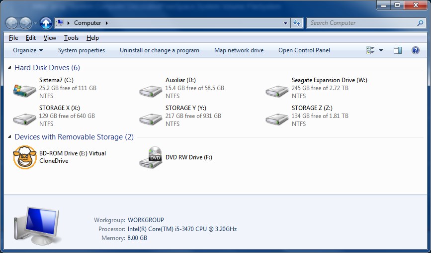

Si no quieres estar viendo las barras esas:
1. Run REGEDIT as administrator
2. Open HKEY_LOCAL_MACHINE\SOFTWARE\Classes\Drive
3. Change the values for both TileInfo and PreviewDetails keys (double click on the keys) by removing the phrase "System.PercentFull;", without the quotes.
The TileInfo key:
Before: prop:*System.PercentFull;System.Computer.DecoratedFreeSpace;System.Volume.FileSystem
After: prop:*System.Computer.DecoratedFreeSpace;System.Volume.FileSystem
The PreviewDetailskey:
Before: prop:*System.PercentFull;System.FreeSpace;System.Capacity;System.Volume.FileSystem;*System.Volume.BitLockerProtection
After:prop:*System.FreeSpace;System.Capacity;System.Volume.FileSystem;*System.Volume.BitLockerProtection
4. Open My Computer, you should be able to see the absence of the color bars. If you still see them, just restart windows explorer, or, if you don't know how to do this, just restart Windows.
5. Enjoy !!!
Así luce el explorador de archivos:
